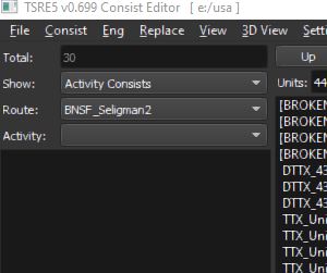

After getting familiair with the TSRE consist editor I ran into this: when selecting consists for a specific activity, nothing shows up except the loose consists (if there are loose consists in that activity). If there are no LC's the activity does not appear.
Am I missing something?
Thanks for any answers,
Rob
It is how it works. Only loose consists are stored inside an activity file.
Player and AI consists are stored inside separate CON files. These files can be shared between multiple activities, so the best way to edit them is to make new consists and edit activity using TSRE route editor.
