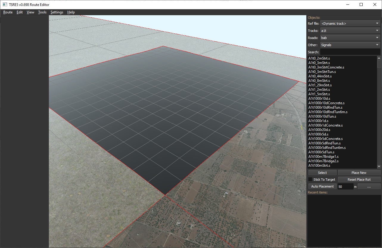

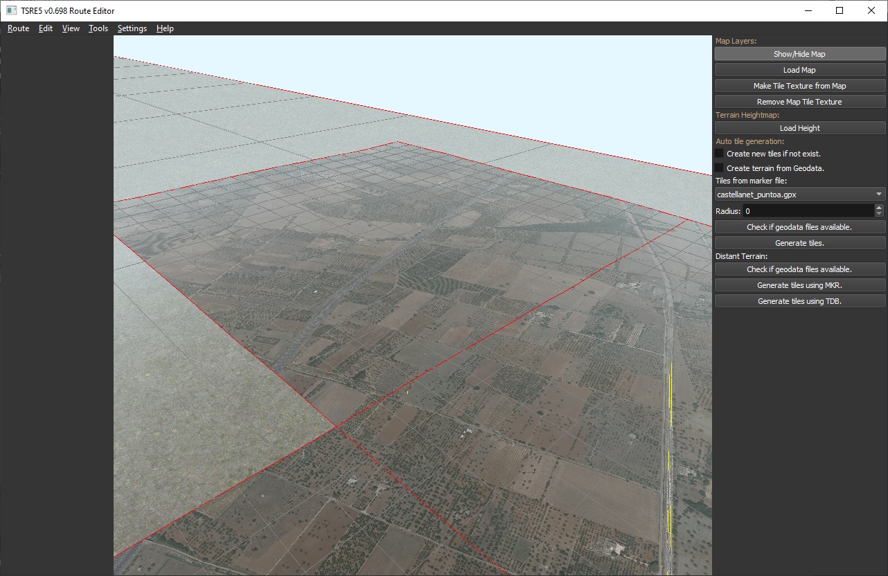

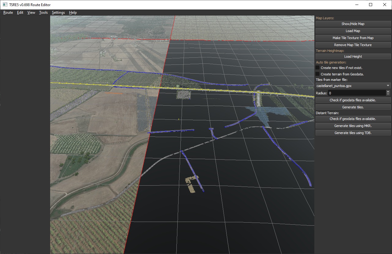

I download a map with "Load Map". I show it with "Show/Hide Map". I see the map. Then I use the "Make ..." function but the generated ace file is completely black. I reopen TSRE5 but the situation is this.
I can continue to show the map with "Show/Hide Map" but in OR I only see a black surface.
Before, this was working for me. Sorry for my bad translation in English. Francesco

I tried to do the same thing more distant in the route but idem, same pretext.
"Load Map" --> "Make..."
"Save" --> "Exit" --> Reopen

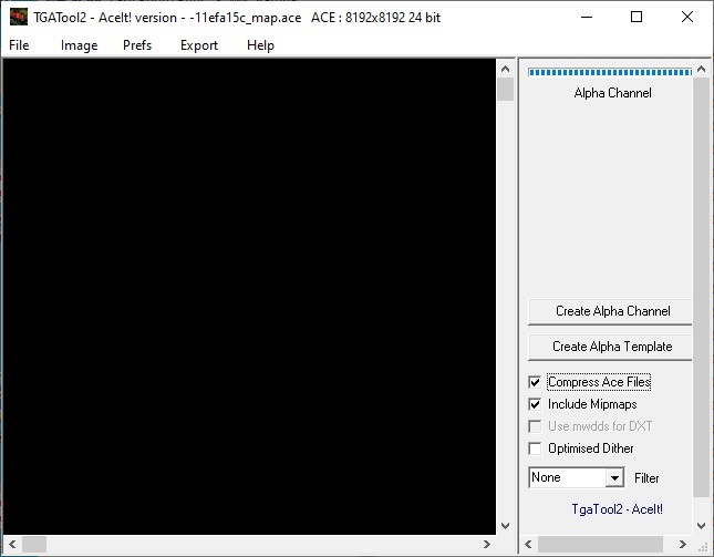

The ace file is generated but it is black.

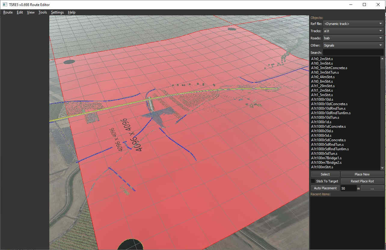

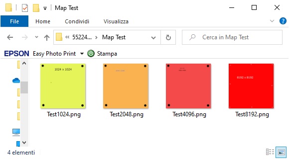

I did this test.
I created four reference images, in png format, in increasing resolution (from 1024 x 1024 up to 8192 x 8192)
Then I redone the same texturing operations, using the four png images shown above as maps (by renaming the files). Well, the last 8192 pixel test fails. I checked the permissions and disk space.
In practice, the ace file has always been correctly generated up to 4096 x 4096. With the red map at 8192 x 8192, the procedure generates a black ace but with correct dimensions!

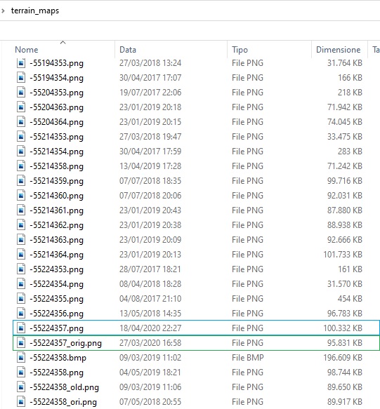

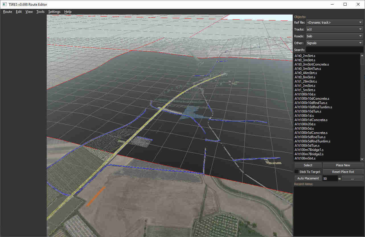

After "Load" map always made "Save to disk" and immediately after "Make ...".
And I've always backed up (with renaming the file) both the png file and the ace file, as shown:
In the green box there is the original map; my map in the blue box.
Anyway, in some intervention before, I did the test again for you on the fly, with another more distant tile ("Load"(Map) -> "Save to disk" -> "Make .." -> "Save"(Route) -> "Exit" // reopen TSRE5).
Obviously the original png map exists, but the ace file is black.
However I will do other tests.
