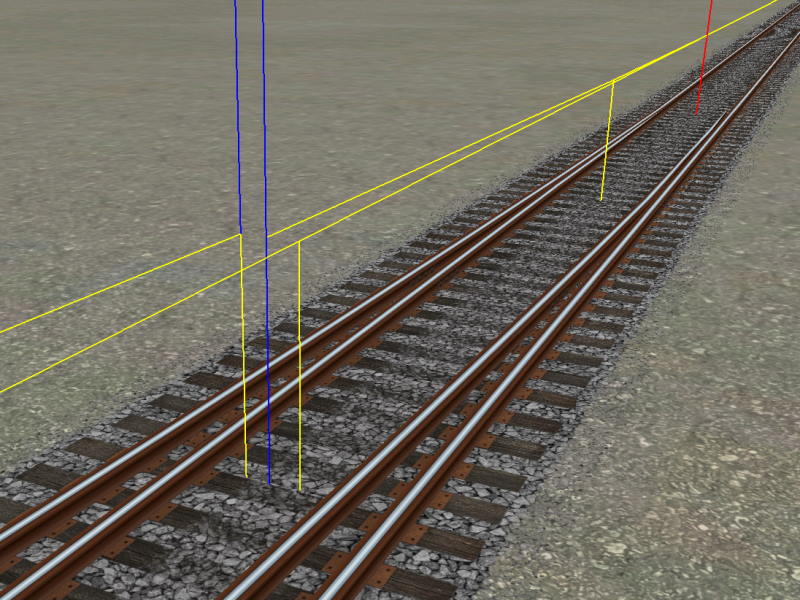

I recently laid a few Mtracks crossovers and noticed the TDB lines on all the No20 and No24 point sections do not line up with their Frog or Xover counterparts. The main route of the TDB gets connected properly, but the diverging route is offset (the problem does not occur with the No15 switch pieces). The shapes match up correctly, but there are 2 blue TDB poles present where the sections meet:
This does not happen when laying the same track sections in the default MSTS editor.
Currently using TSRE5 v0.7.002 with build 0056 of the global tsection.dat.
Has anyone experienced this? Is there something that TSRE5 does differently when placing/writing track items that could cause this error?

Maybe there is a tsection bug in this shape definition, but MSRE has more tolerance for radius when snapping tracks togeher.
TSRE doesn't allow that huge offsets.

Following up on this issue, I want to share the root cause and a work around for laying Mtracks points in TSRE:
I noticed TSRE has trouble recognizing "SectionSkew" entries in the global tsection.dat when placing track shapes that reference them. This leads to misaligned TDB vectors even though the track pieces snap together properly in the editor. The point shapes for Mtracks #20 and #24 switches (M1tPntNo2*.s) happen to start with a skew section followed by a curve for the diverging path. When placed in TSRE, the initial ~0.5 degree skew gets skipped causing the TDB vectors to miss the blue pole on the adjacent Mtracks frog or xover shape. I tested this theory by placing the default A1t10mSkew.s in TSRE and found the same result - the TDB vector doesn't align with the following piece.
What I saw in TSRE when placing a #20 Mtracks point, global tsection build 0056:

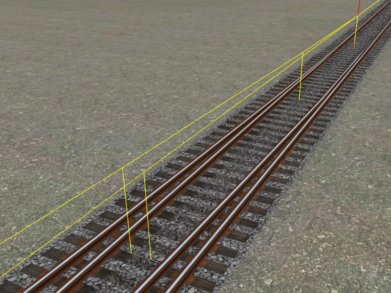

Here's the result when I place a #20 Mtracks point in TSRE with the include file in place:
Everything lines up without the unwanted blue poles. Throughout this process, I learned a lot about the structure of the tsection.dat and the usefulness of patching it locally with an include file.
