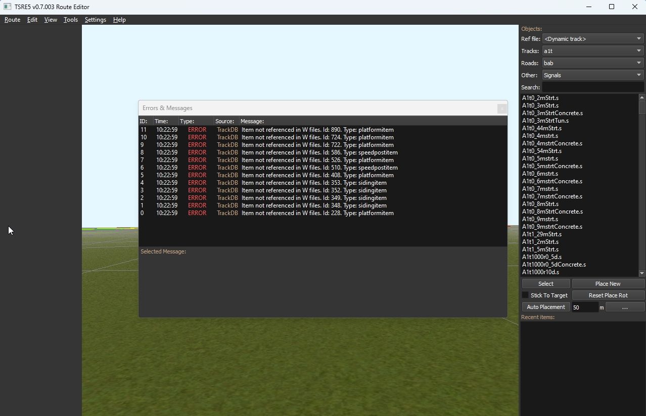

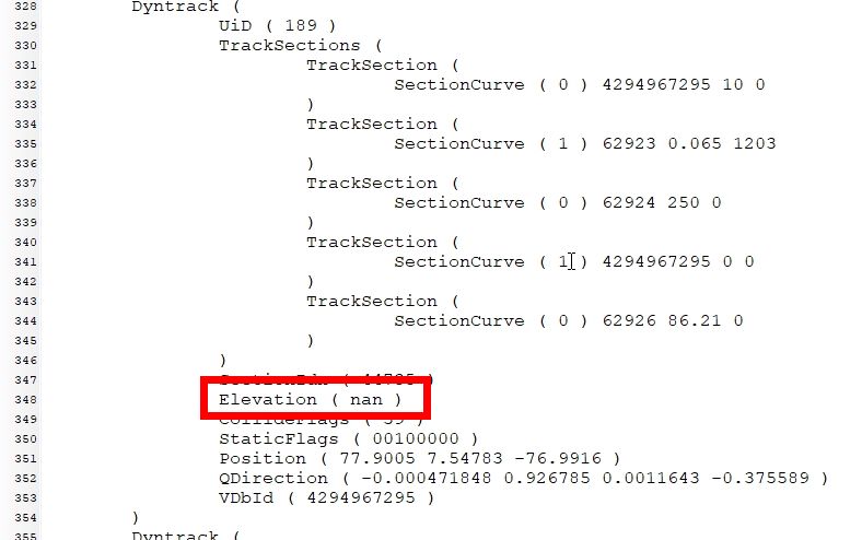

For one thing, contrary to previous statements, there are errors in the route after all.
Screen Shot 01-10-23 at 10.23 AM.JPG (126.47 KiB) Viewed 109605 times
Screen Shot 01-10-23 at 11.02 AM.JPG (48.33 KiB) Viewed 109605 times
Screen Shot 01-10-23 at 10.20 AM.JPG (42.6 KiB) Viewed 109605 times
But these errors have no effect on the DynTrack.

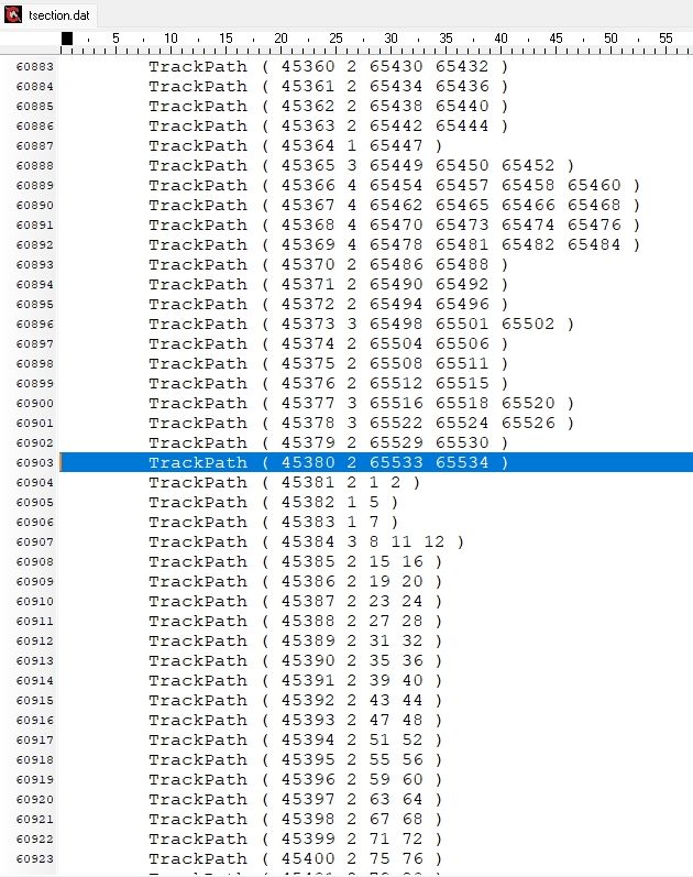

The big problem in the route is the internal tsection.dat. This was also mentioned by the previous speakers. There are serious errors in the file structure here.
Kapitaen13
Posts: 46
Joined: 16 Jan 2019, 15:21
Screen Shot 01-10-23 at 01.17 PM.JPG (127.73 KiB) Viewed 109604 times
From line 60904 the big mess begins. After the trackpath number follows the number of sections. This is followed by the section. This must not be smaller than 40002, but see for yourself!

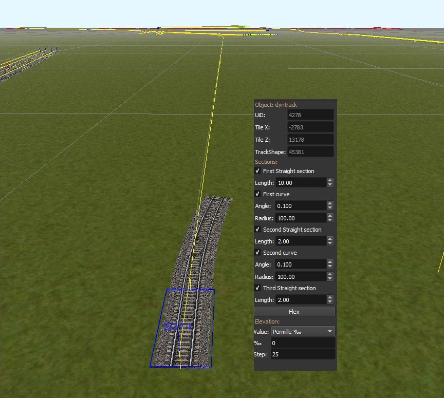

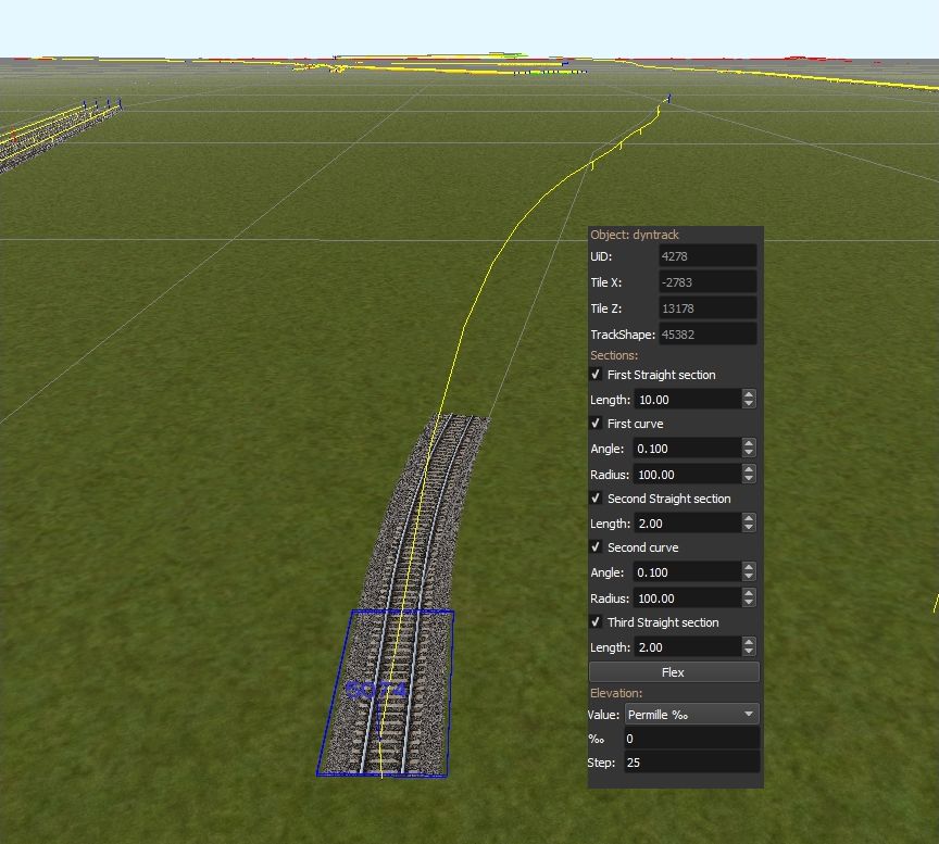

If you delete the unused sections and path from the tsection, you can put DynTracks back into the route, but they will never match the track again.
Even just re-integrating via the z key results in different track layouts.
Screen Shot 01-10-23 at 04.08 PM.JPG (100.66 KiB) Viewed 109604 times
Screen Shot 01-10-23 at 04.07 PM.JPG (101.07 KiB) Viewed 109604 times

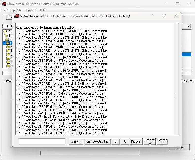

I then tried to rebuild the rail database via ROUTERITER TSUTIL. Unfortunately this was developed for the MSTS and I get hundreds of errors because in the MSTS the radius of the DynTrack must be negative.
Screen Shot 01-10-23 at 01.15 PM.JPG (134.36 KiB) Viewed 109604 times
Sorry, but if you don't have an older backup, I don't see any chance for a further build....

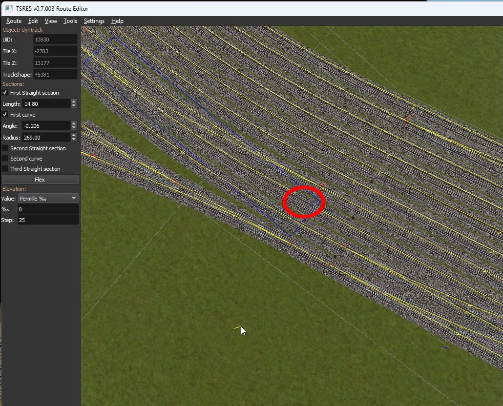

The best handmade result obtained is this:
.trk
	RouteStart ( -2783 13177 240 940 )
__________________________________________
tsection.dat
	TrackSection (
		SectionCurve ( 0 ) 65536 14.8 0
	TrackSection (
		SectionCurve ( 1 ) 65538 -0.206 269
	TrackSection (
		SectionCurve ( 1 ) 65539 0.206 269
	TrackPath ( 45381 2 65536 65538 )
_______________________________________________
.tdb
		TrackNode ( 151
			TrVectorNode (
				TrVectorSections ( 3 0 39877 -2783 13177 10815 0 2 00 -2783 13177 240.71799 0.97300601 840.56403 0 0.061940242 0 65536 45381 -2783 13177 10830 0 1 00 -2783 13177 241.33701 0.97300601 850.54498 0 0.061940271 0 65538 45381 -2783 13177 10830 0 1 00 -2783 13177 241.95601 0.97300601 860.52582 0 0.061940271 0 )
			TrPins ( 1 1
				TrPin ( 164 0 )
				TrPin ( 112 1 )
_________________________________________________
w-002783+013177.w
	Dyntrack (
		UiD ( 10830 )
		TrackSections (
			TrackSection (
			TrackSection (
			TrackSection (
				SectionCurve ( 0 ) 4294967295 0 0
			TrackSection (
				SectionCurve ( 1 ) 4294967295 0 0
			TrackSection (
		SectionIdx ( 45381 )
		Elevation ( 0 )
		CollideFlags ( 39 )
		StaticFlags ( 00100000 )
		Position ( 241.337 0.973006 850.545 )
		QDirection ( 0 -0.0309652 0 0.99952 )
		VDbId ( 4294967295 )
