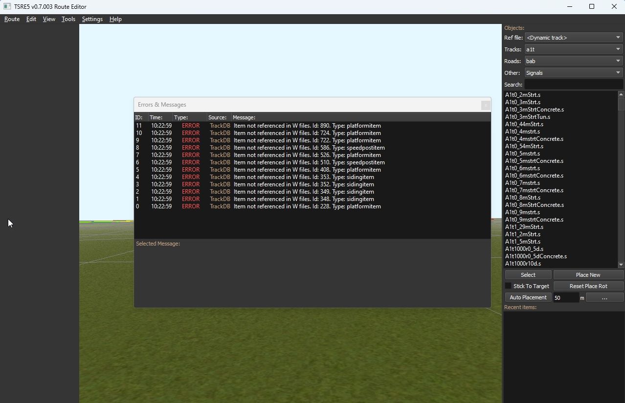

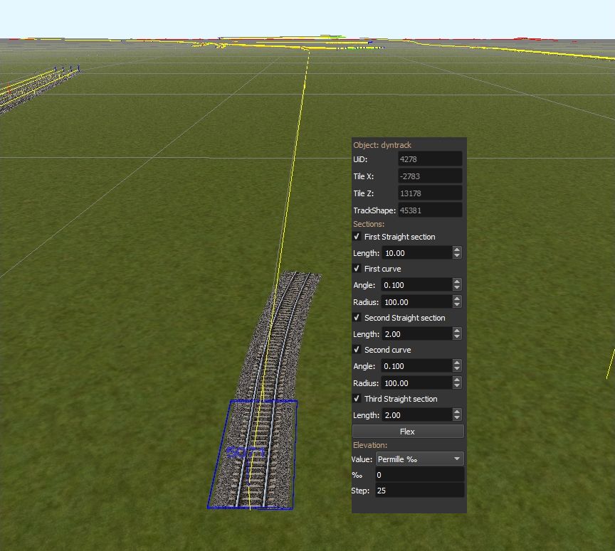

Screen Shot 01-10-23 at 10.23 AM.JPG (126.47 KiB) Viewed 114258 times
Screen Shot 01-10-23 at 11.02 AM.JPG (48.33 KiB) Viewed 114258 times
Screen Shot 01-10-23 at 10.20 AM.JPG (42.6 KiB) Viewed 114258 times
But these errors have no effect on the DynTrack.
The big problem in the route is the internal tsection.dat. This was also mentioned by the previous speakers. There are serious errors in the file structure here.

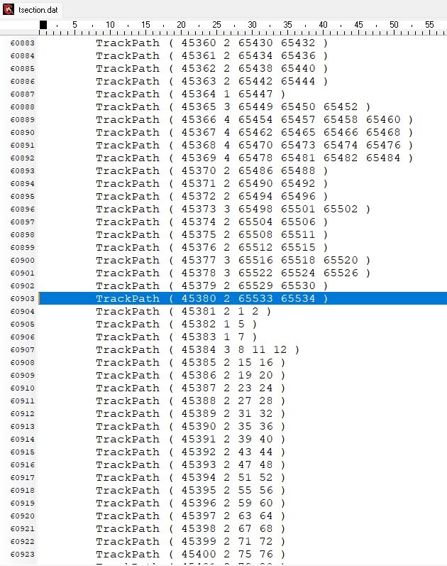

Screen Shot 01-10-23 at 01.17 PM.JPG (127.73 KiB) Viewed 114257 times
From line 60904 the big mess begins. After the trackpath number follows the number of sections. This is followed by the section. This must not be smaller than 40002, but see for yourself!
If you delete the unused sections and path from the tsection, you can put DynTracks back into the route, but they will never match the track again.
Even just re-integrating via the z key results in different track layouts.

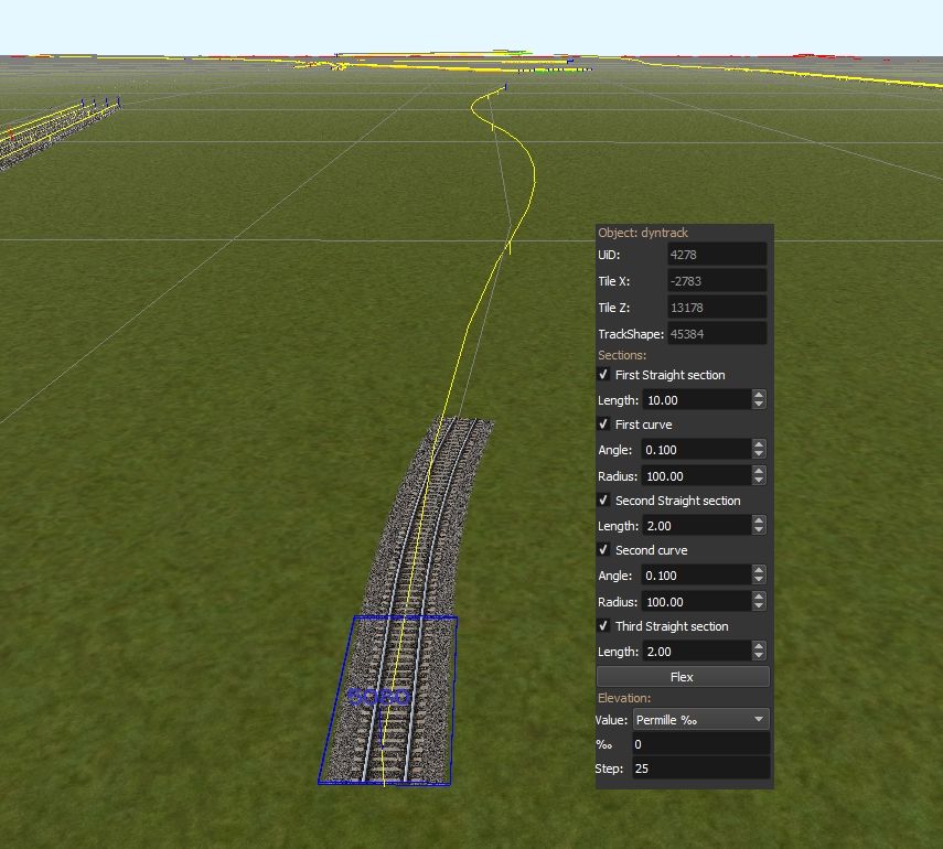

Screen Shot 01-10-23 at 04.08 PM.JPG (100.66 KiB) Viewed 114257 times
Screen Shot 01-10-23 at 04.07 PM.JPG (101.07 KiB) Viewed 114257 times

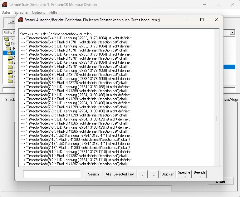

Screen Shot 01-10-23 at 04.06 PM.JPG (99.87 KiB) Viewed 114257 times
I then tried to rebuild the rail database via ROUTERITER TSUTIL. Unfortunately this was developed for the MSTS and I get hundreds of errors because in the MSTS the radius of the DynTrack must be negative.
Screen Shot 01-10-23 at 01.15 PM.JPG (134.36 KiB) Viewed 114257 times
Sorry, but if you don't have an older backup, I don't see any chance for a further build....
